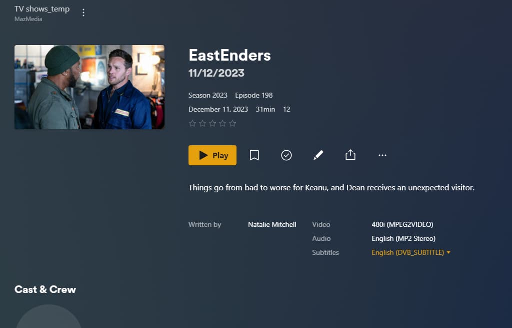

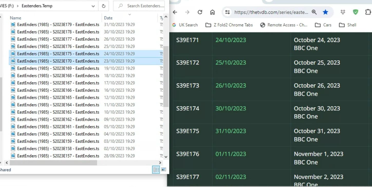

Hello @sa2000 & Co,
Over the last month I’ve noticed that the episode synopsis was incorrect on one of my DVR shows (Eastenders - UK soap opera).
When I cross-checked with TVDB, I could see that the episode number was incorrect - the number was a week ahead (see attached images 1_1, 1_2, & 1_3).

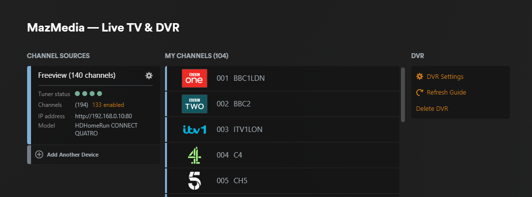

The line-up name - Freeview (see attached DVR settings screenshot)
Channel number and channel name - 001 BBCLDN
Issue - When looking at the DVR recordings folder and comparing to TVDB, I can see that the incorrect episode titles (numbers) started to be assigned on 24/10/23 (see attached DVR recordings screenshot).
The episode number on 24/10/23 should’ve been 171, but 175 was assigned by the DVR instead (see attached TVDB screenshot).
My country - London
Postal code - SE25 4TJ
Region/market - London
Version of Plex Media Server in use - Version 1.32.8.7639
Can you please advise how to get this resolved?

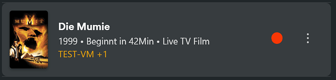

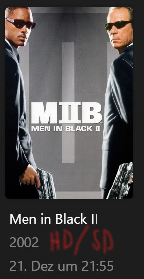

Would it be possible to display the channel and/or the resolution (SD/HD) for planned recordings?
Also on Browsing it would be nice.
I have Plex server version 1.32.8.7639
