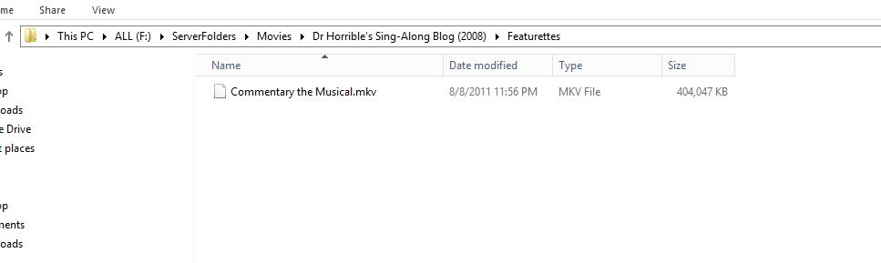

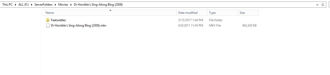

Here’s a screenshot of the folder layout and the file:

Please show the complete content of this folder:
F:\ServerFolders\Movies\Dr Horrible's Sing-Along Blog (2008)\
There must be only one video in this folder directly.

Yes. Here’s the folder above it:
