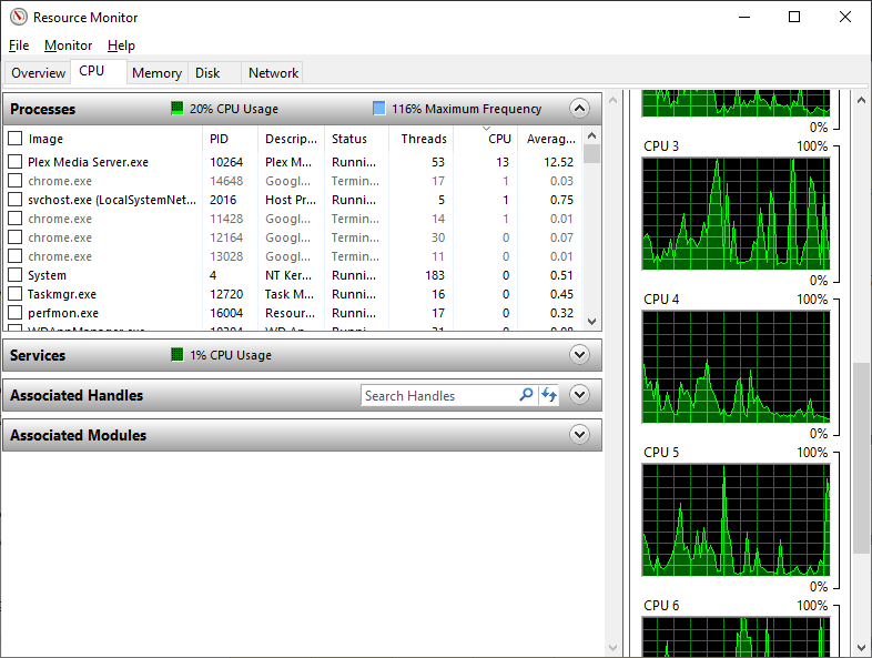

CPU may not be at 100% but is one core at 100%?
Hadn’t noticed that option before in the app. I cleared the cache there but still getting the same error. On the browser, it’s playing but it’s slow to load between songs.
8,479 files.
CPU spikes to 20% but it’s distributed across the cores.

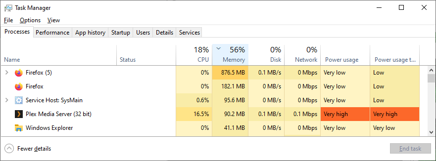

One thing that I don’t recall being high before is ‘power usage.’ Also, before I can say it was 100% Plex, I see that I had a Windows 10 update deployed on Nov 15 that had a bunch of junk. Not sure if that was exactly when my problems started.
