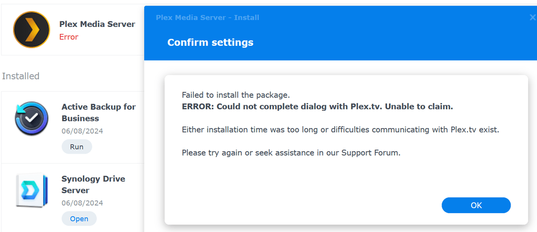

After trying to do the steps in part 2 I got this error message:
A couple of days ago, my server disappeared from all my devices and I get the prompt in my account to create a new one, that’s why I thought it may have been deleted, but maybe it’s just an error trying to connect to it.
Given it can’t talk.

This is the second machine tonight where DSM can’t get to the internet / plex.tv
Jun 14, 2024 06:07:50.227 [139870345841464] WARN - [HttpClient/HCl#19] HTTP error requesting POST https://plex.tv/api/claim/exchange?token=xxxxxxxxxxxxxxxxxxxxmdsi7V (6, Couldn't resolve host name) (Could not resolve host: plex.tv)
Jun 14, 2024 06:07:50.227 [139870283840312] DEBUG - [Req#46] MyPlex: Did token exchange for claim (returnCode: -6)
