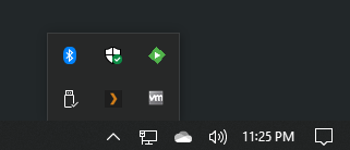

Are you attempting this on the same PC as the Plex Media Server? Can you verify that the Plex Media Server icon is present in the Windows 10 notification area by the clock:
Right-click on it and select “Open Plex” and see if that works. If not, open an Edge InPrivate window and type in the address in my earlier post, please.

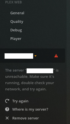

Wow, Phil, now I am losing it. My server is now connected, but I have two instances of my network in the left panel with the same network name. One which is connected and does indicate I have Plex pass and the other which continues to try and connect. Why there are two is beyond my comprehension of where the second one came from. Of course my libraries are empty, but that’s not a problem as it will only take a few minutes to rescan what I originally offered. How do I go about about removing the “cloned” server? I’m sure I’ll find the answer to that easily, but I don’t want to risk something else going haywire. BTW, after several installs and uninstalls of PMS, I did notice the icon wasn’t in the notification area until today’s install. Weird stuff happening here. Thanks for all your help, it’s really appreciated.
Ah, progress. The duplicate is probably your account remembering the old server. If you gave them the same “friendly” name it would look like a duplicate. You should be able to remove it by going to settings and selecting it from the server drop-down on the left (make sure to select the one which is “Unavailable”):
Screen Shot 2019-12-20 at 11.25.02 AM
You can then click “Remove Server” to permanently remove it:
Screen Shot 2019-12-20 at 11.27.14 AM
After doing so, it should be removed from your server list. One final thing you may need to do is reset your web client preferences from Settings -> (Plex Web) General -> Reset Customization. That will take you through the client setup again.
