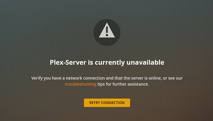

No matter what PC I load Windows Plex Server it can never find my Plex Server with my files.
Plex-Server is currently unavailable
Any suggestions?

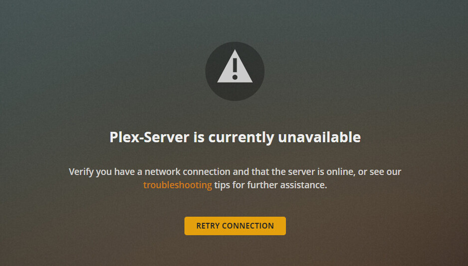

Any suggestions?

Ok, so I have tried to install Plex Server on 2 different PCs as I thought the 1st PC maybe had conflicting software. Both PCs are Windows 10.
Both PLEX Server software installs are version 1.2.1.0.3711-b509cc236-x86
Plex opens but my own PLEX server with all my folders gives an error.

Yes I am but I also tried on My Nvidia Shield + TV and get the same error…

It says “The Site can’t be reached”
I have had Plex for years…It no longer lets me see “my” Plex Server. I will uninstall Plex off the PC and try again…doubt that will work…but will try

So I removed it from the router and placed Plex Server back on my PC. Since then, about a month now I have not been able to access my Plex Server. I reinstall everything and it works…then at night when I turn off my PC and then in the morning restart my PC it is not available. Even if I decide to leave the PC on it does updates and reboots.
I click Home and More and I get that error.
I recently tried it on a different PC and it did the same thing…just this morning I uninstalled and reinstalled it again and called it a Different Name…ie WC Plex Server and it actually works.
I restarted the PC and it is all there !!
So it seems there was a glitch with just using the same name I had … Plex Server…not sure why but I am just glad it works now.
