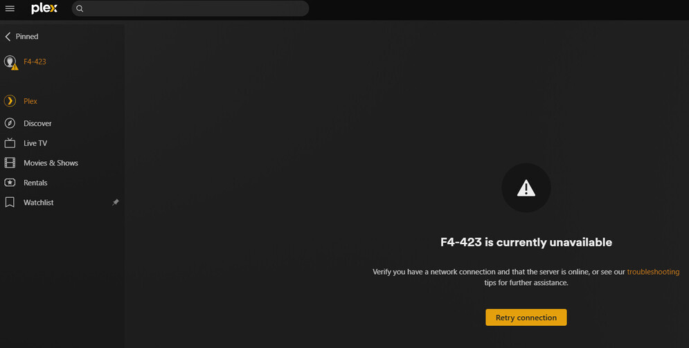

Found the xml filed and renamed it. Restarted PMS and still see the same error. I also logged into my plex account and see this. Tried the retry connection option. Nothing. When I click on the troubleshooting, it just takes me back to the troubleshooting guide
Well… at least it’s showing you the Plex Web app and no longer the generic error page.
Do you get this when opening the web app using the NAS’s local IP address?
Ha! Indeed this is progress. If I login using the NAS local IP address and the port number for plex (32400), I get the same “page isn’t working right now”
