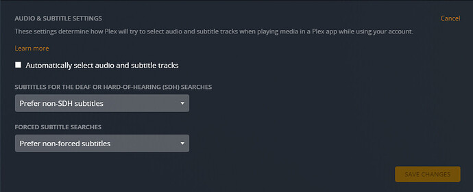

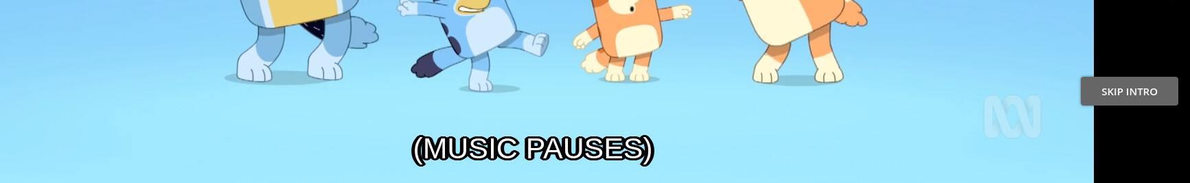

I have setup a managed account for my daughter, and every time she watches something it has subtitles on by default.
I cant find anyway to disable them like the rest of the profiles
any ideas how i can do that?
Should be exactly the same as for other users in the audio & subtitle preferences of her account settings (while signed i. With her account)
https://app.plex.tv/desktop/#!/settings/account
what should i set here
You’re not in her account settings, are you?
Yes i am, chose her profile then went to settings
You should instead click on the avatar, and select account
@dane22 mine is already set that way
Try and remove the checkmark for “Automatically select…”
makes no difference
Hmmm…I actually just went through this, and can concur that the Web Client have issues here
So this is what I did
In the Web Client, I set the prefs like this:
But sadly, even after logout of the managed account, it didn’t stick, so I also did the following:
Downloaded Plex for Windows
Ref: Media Server Downloads | Plex Media Server for Windows, Mac, Linux, FreeBSD and More
Using that, I logged in as my managed user, and now the settings was respected, even in the Web Client
