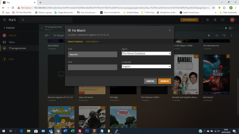

A’ight - let’s make it look.
Put in “Marvel’s” and nothing else.
Then in a Hail Mary - change the Agent to TMDB in the Agent Dropdown in Search Options.
If that won’t work - we need more and more smarter support…lol

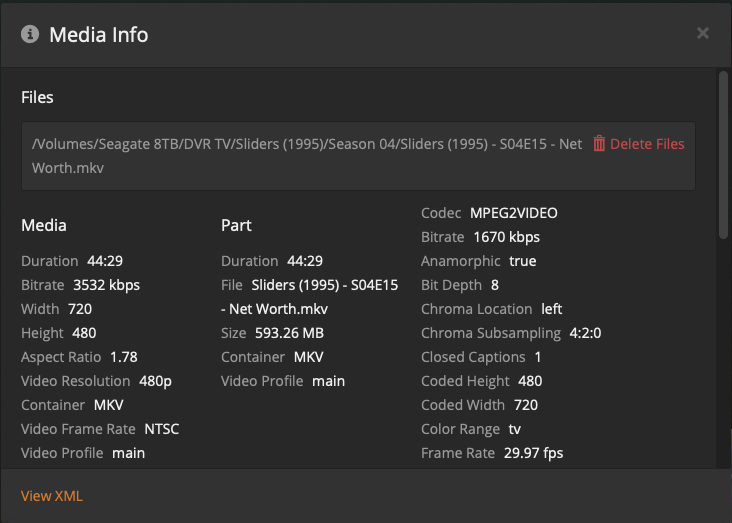

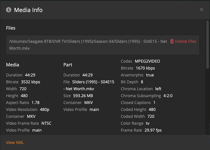

Can you provide a screenshot of the “Get Info” dialog when it’s being mis-detected? Click the ellipsis in the bottom-right of the episode poster and select “Get Info.” The result will be something like this:
Make sure the “Container” shown is MKV. It is possible to rename MP4 files with a .mkv extension; however, the files are still in an MP4 container and embedded metadata may be used.
If the container is MP4, you’ll need to correct the embedded metadata or reorder your TVDB agent priorities. Or both.

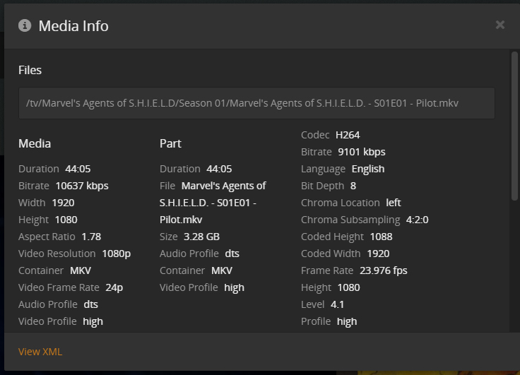

Here you go Philipsw. I accidentally deleted the season 7 episode 1. got too clicky. OOPS! I’ve downloaded season 1 Ep 1 and this is the container for it.

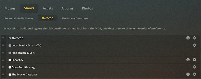

It shouldn’t be needed for MKVs, but it won’t hurt to try it: Move “Local Media Assets” down in priority for your TVDB agent configuration (if you haven’t already). Settings -> Agents -> Shows -> TheTVDB:
You may need to Dance the show afterward.
@pshanew i have already moved it down. It’s down at the bottom I think. I’m going to try a different Marvel’s Series and see what happens.

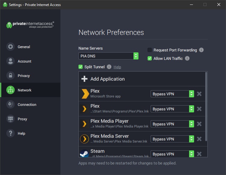

Does PLEX mind running on a server running a VPN?
I’ve just disabled my VPN and tried to search and it found it straight away doing a match!!!
It was the last thing I hadn’t tried doing.
It’s TV Show - in TMDB’s database like thousands of other TV Shows.
The link above clearly shows it’s TV Show.
There you go.
I use PIA - and use their ‘Exclusions’ to Exclude Plex from it’s ‘protection’ and things work well. Plex doesn’t need VPN protection anyway.
