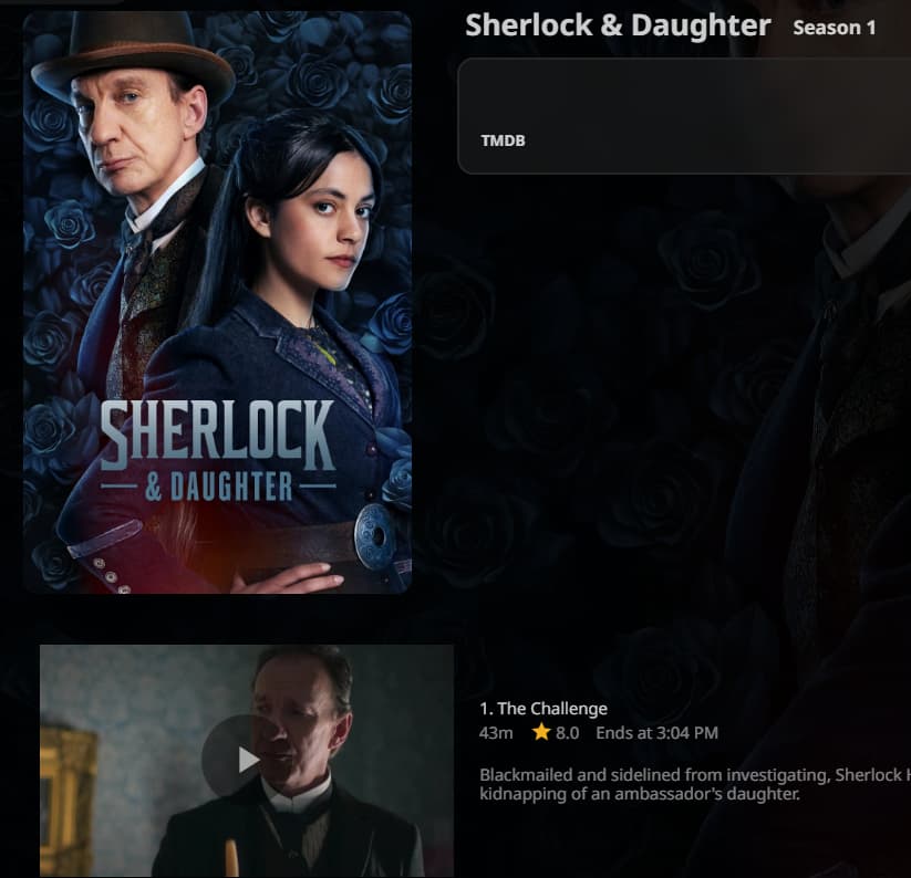

This has cropped up yet again. Same server has Plex 1.41.7.9717 and Jellyfin 10.11.0 on it, pointed at the same NFS mount for media. Jellyfin has absolutely zero problem matching movies and series information while Plex displays things like this:
Jellyfin:
So this is NOT DNS related as keeps being mentioned. If it were, calls from Jellyfin to TheTVDB and TheMovieDB would fail since they are installed on the same physical machine, using the same interface, gateway, and nameservers. They do not. This is within Plex.

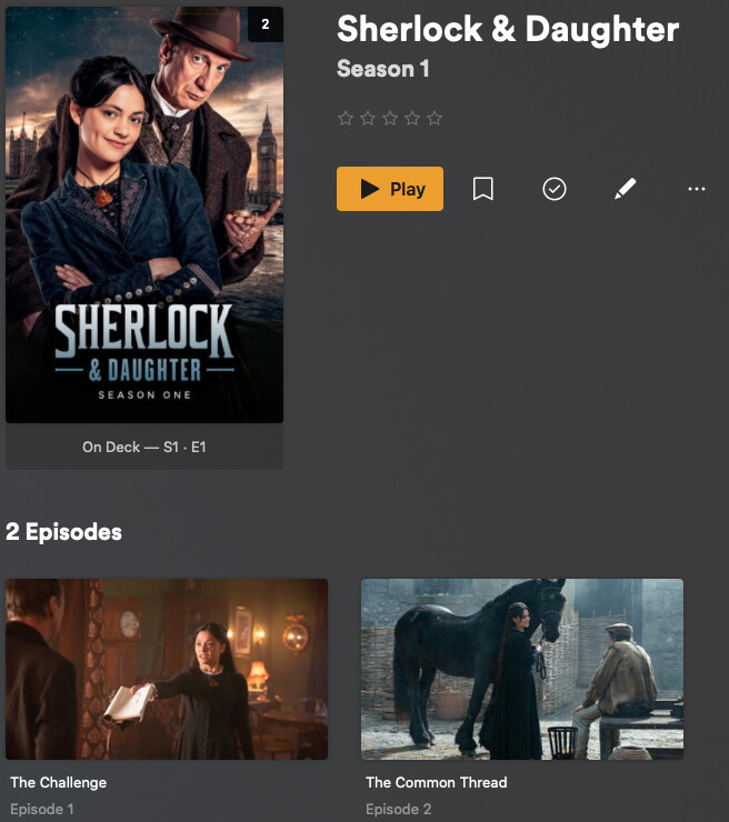

Interesting. In my test library, this:
dvr/
└── test_tv    <--- My test library points here...
    └── Sherlock & Daughter (2025)
        └── Season 01
            ├── Sherlock & Daughter (2025) - S01E01.mkv
            └── Sherlock & Daughter (2025) - S01E02.mkv
Produces this:
So the modern Plex TV series scanner/agent combo can work. The information is there at watch.plex.tv, and is queryable at metadata.provider.plex.tv.
