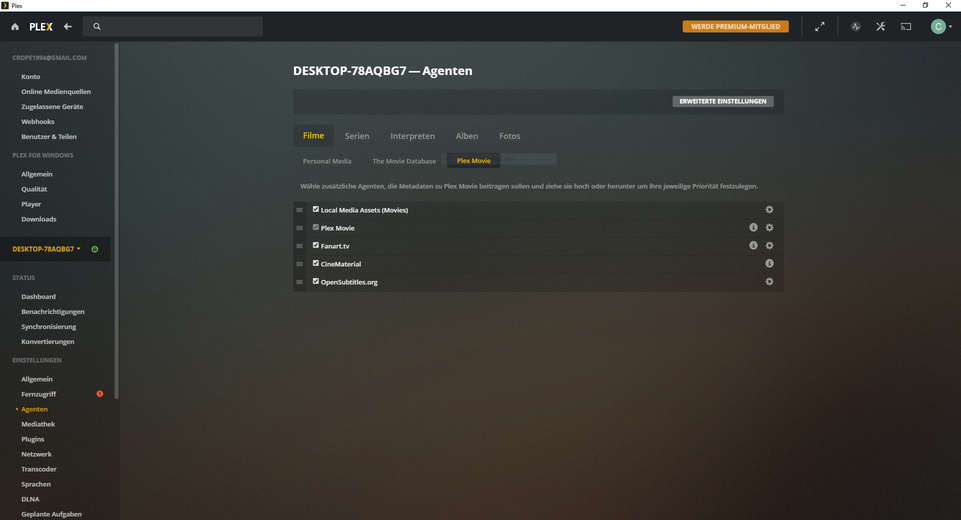

and here is a screenshot for the agents
Because he didn’t download anything i checked all the options. But that doesn’t change anything.

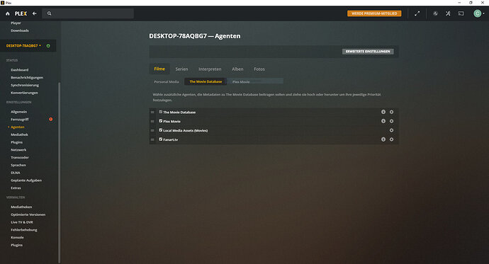

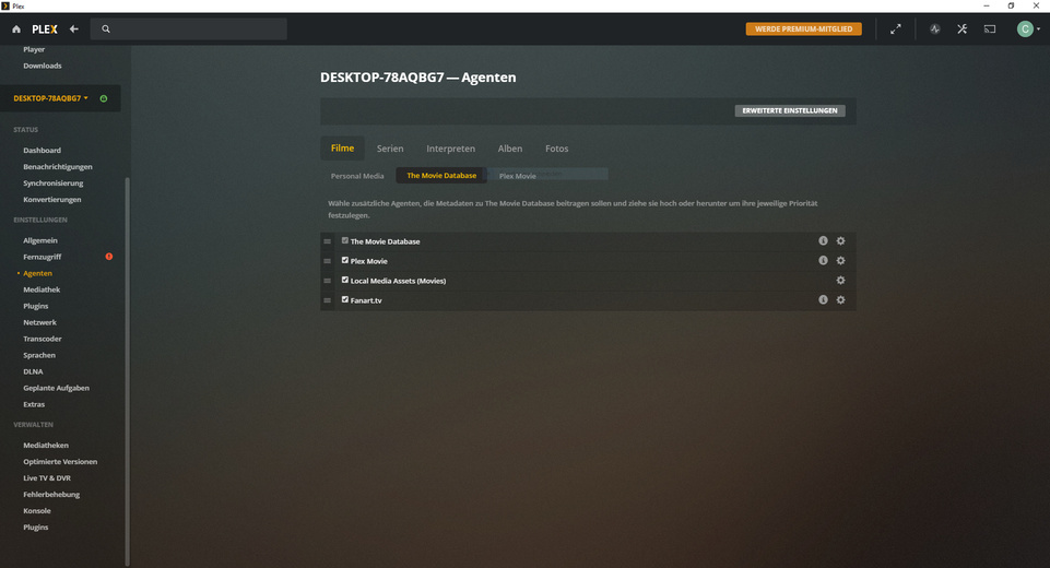

This movie has been matched with the TMDB agent. So you need to click on ‘TheMovieDatabase’ first.
Then grab one of the lines and drag it down- or upwards one position.
Let go and then drag it back to its original position.
Now Refresh Metadata on the movie.
i changed the order to “TheMovieDatabase” first then Plex movie but it doesnt work as well.

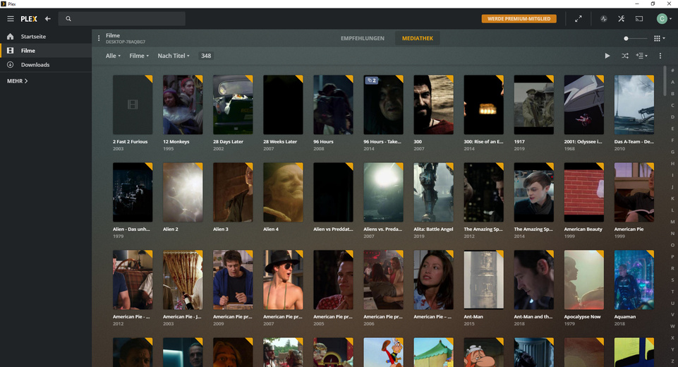

Now my List looks like this

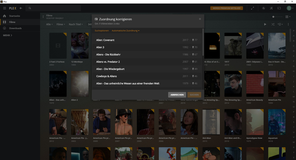

Normally it looks like this when he can’t assign the movie. but normally you can do that manually.
Btw my Plex finds the movies but still no metadata

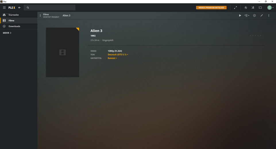

Could you dive down onto the preplay page of a single movie?
What is there and what is not? I can see that the movie titles are mostly correct, but what about the rest?
Nothing else Year and Name. But i think he gets that maybe out of the tags inside the file
