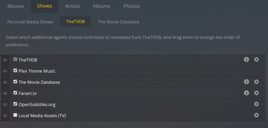

Check the agents it is searching with. Every so often, mine reset and go based on local media assets first, instead of what it should be. These scenarios require rearranging the agents properly again, and then manually matching the stuff that you just added since.

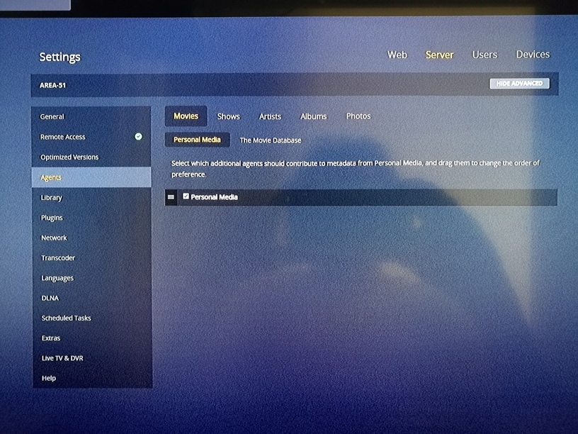

I’ll give it a go when I get home tonight, thanks for the tip! I may have to post a pic of what my settings are though as it appears that personal is locked along with the movie database on a different tab. Also I tried a different program to get Metadata and that didn’t seem to work either so it may be something with my computer settings blocking it instead?

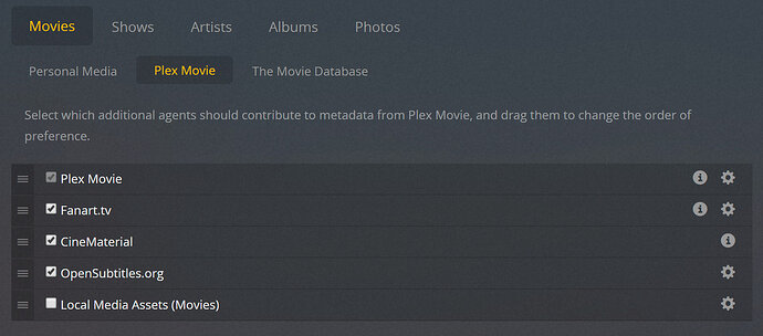

This is what I have for my agents. Scans properly, and finds most everything.

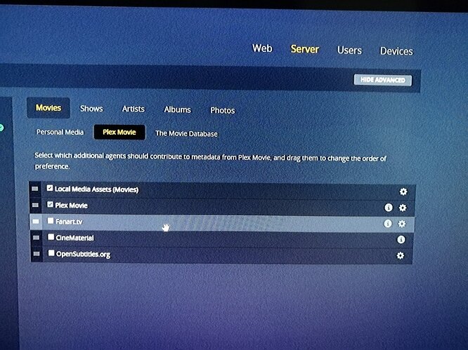

I don’t even have the option for Plex Movie Scanner? Something is definitely wrong with my setup but I have no idea how it happened…
Also Personal media seems to be locked…
Yeah, I am not sure on that one. If you are a Plex Pass subscriber, you SHOULD have that option. So I am not sure why you don’t. Outside of manually matching your movies/shows, the only other advice I would have is to attempt rebuilding your library from scratch.
