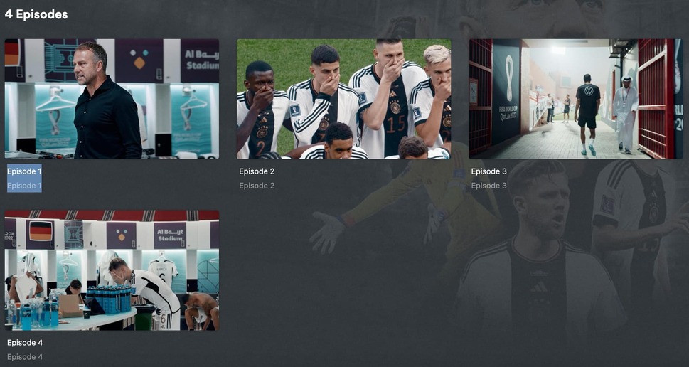

Let me focus on All or Nothing first. Somehow, I cannot receive the same info as you do. Any thought what I can do to troubleshoot?
It matches. It also gives me the show description below. But all episodes are “Episode 1” rather than title and no description.

Even the number doesn’t change?
