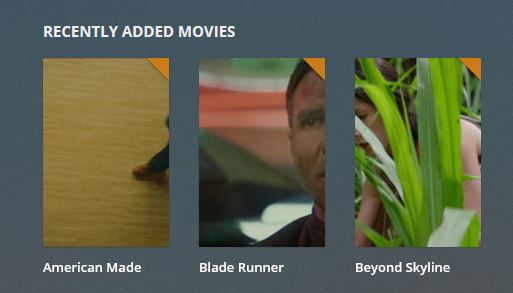

This started about week or so ago, but when I add movies to the plex server, the server is not updating the metadata, posters etc for the file. It will create a generic a generic poster and backdrop from the movies and nothing else. I went through the settings dozens of times, I have poured through the forums looking to see if I can resolve it, but I have not been able to.
Attached is the logs from the server can someone take a look and see what I have broken?

I have not had a chance to fully reboot all the systems, but will do that later today, I did clear all the idx and sub files from the library. I also was able to do all the suggestions that OttoKerner made and I have the same results. I will also try to load on a different machine to see if it may be a network issue. Below are the logs after I did the suggestions. On the Plex webpage this is what I see:
Thank you for all your help and suggestions.
