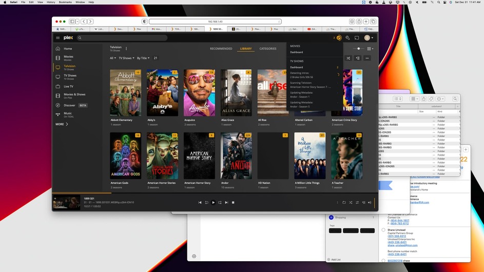

here an example of a scan taking place as I post
andor has only 1 season and is registering 10 while American horror story that has 7 seasons is showing as having 1
I do not know where all the episodes from the other seasons like 7 went but I suspect they are mislabeled and buried in andor somewhere
the same naming conventions were used to label all seasons of American horror story and yet something has gone awry that did not happen with 1883 or 68 whiskey

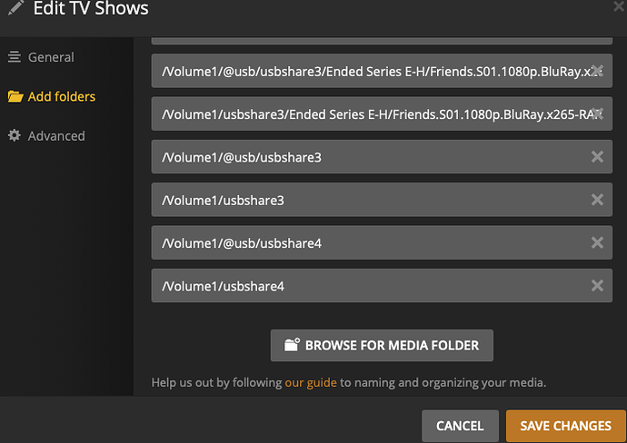

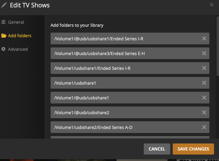

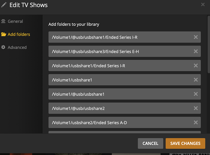

If you edit the library what file paths are listed under the add folders section?
Don’t add individual show or season folders to the library. Just add the top-level folder which contains your shows. They way you’ve added all kind of different folders, this is due to cause trouble.

I will also note that you have recursive folders in your library.
  • /Volume1/@usb/usbshare1/Ended Series I-R
This will cause a LOT of headaches. See above for proper naming/folder structure.
