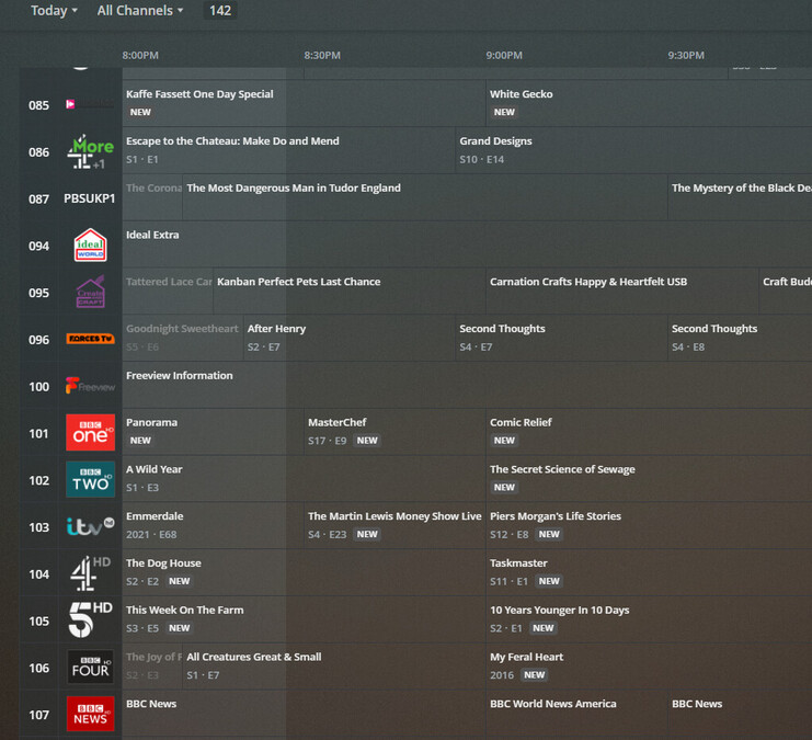

if i view all channels and look at channels 101 to 111 then i see the guide data. If i select HD Channels from the drop down then there is no guide data displayed for 101 to 111 and yet the channels are shown as they are HD.

the weird thing is that it is exactly the same channels so the programme data is there. Just for some reason it isnt showing it at the moment.

It does not seem to affect the guide if “All Channels” is selected. Only when the “HD Channels Only” is selected.
i have no idea how you know if you are using the new plex guide service. I deleted and recreated the DVR a few days ago when i noticed this issue so i should definitely have the latest guide service.
I agree, i have noticed that when looking at all channels, you can see the programme info on the HD channels but look at the HD channels only and it Unknown Airing
