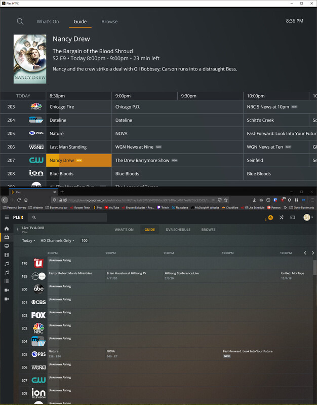

I dont think its down to the guide, the info is there if you view under All Channels. It would appear to be an issue that has been introduced in the last few releases (Beta Channel) from what I can tell. I can only recall seeing this issue in the last week or so.

Ok this just gets weirder. So all of my guide data shows up with the new HTPC client that Plex dropped a beta for in the forum. https://forums.plex.tv/t/introducing-plex-htpc/703075

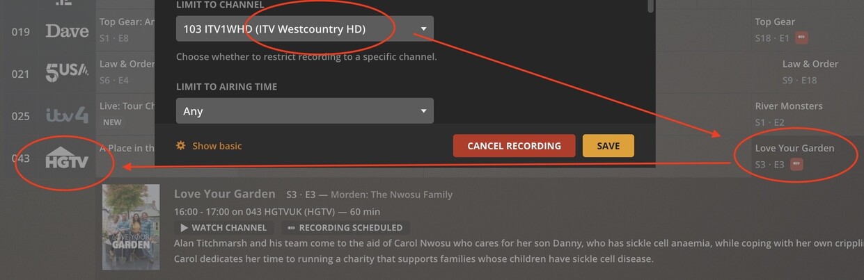

I started to get ghost recordings. The scheduled recording is not showing up in DVR schedule, but is shown on the EPG on a wrong channel despite the recording being limited to a single HD channel.
this isnt ghosting… it happens whenever you do series record and the programme is on multiple channels. it is just showing you that that programme is series linked for recording. It doesnt mean that it’s actually going to record that instance of that programme.
I get that regularly with stuff like formula one. shows it recording every instance of it in guide including all the repeats on Sky Sports F1, Sky Sports F1 HD and also include Formula One on Channel 4 when it’s live on there! . only ever records from Sky Sports F1 HD though as that’s what it is restricted to.
Well, then it’s not a very good ‘feature’ as it gives false positives even when the recording is restricted to a certain channel. The record icons should only be shown on the programmes which will actually be recorded, as all of these settings can be configured in the recording (time, channel, HD, new/old). It’s not good for usability.

Ever since upgrading server to Version 1.22.1.4228 the guide does not show most of the channels as HD (so if you select HD channels only, you get unknown airing). As long as DVR is set to “Prefer HD” as tsps1981 stated it will record and the recordings are in HD.

Still having the same issue of “Unknown Airing” when “HD Channels Only” is selected. It does not seem to affect the guide if “All Channels” is selected.

Same issue - I have guide data on SD but nothing on HD.
