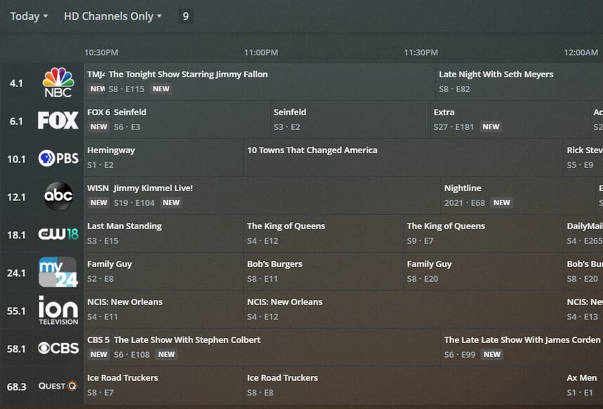

the update in 4.54.5 that you are referring to didnt fix the issue. What you now get is the hd channels listed (with programme content) plus the SD channels listed with programme content. I think the only things it doesnt show when you view the HD Only filter is the radio channels. The problem is still there as no programmes are being flagged as HD so if you have the recordings set to HD Required then the recording fails, set it to prefer HD then it will record the content from the HD channel. Plex is clearly not aware about the programming being in HD on the HD channels.
Interestingly, if i switch between All Channels and HD Only filter before it shows the filtered guide i can see the channel count monetarily flick from 239 (All) to 65 (HD) to 125 (HD Only filter).
IT never actually shows only the 65 HD channels though. This would be the correct amount of true HD channels with HD content for my guide. 125 channels seems to be a strange mix of the HD channels and a large amount of the SD channels too but I cannot work out why

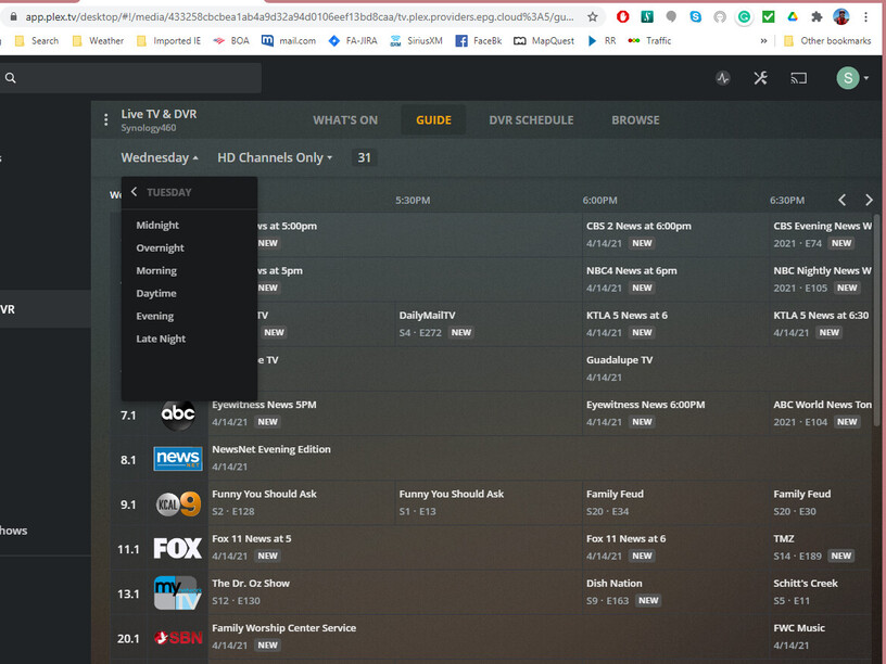

Seems like most of the issue has resolved. the only change I made was an update to DSM and the channel guide was probably updated. There is only one channel 6.1 that still shows that issue. See attached. My web version is 4.53.0
Further to my earlier post - this is now with the Plex Web team - a similar issue was fixed before. If after you get the HD Only filter display HD channels + SD channels - if you now hit the F5 button to refresh the browser screen, it will give the HD Only list
The HD Only filter is now working on channel attribute - apart from the suspected Plex Web bug I mentioned where some cached SD channels get added to the view

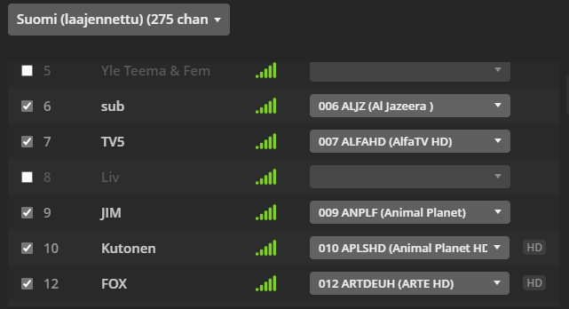

Could somone please fix the Finnish guide data? Basically all of the channels are saying that there’s no data.
Also, there’s the thing that the DVR setup channel to guide channel matcher does not find basically ANY of the channels right. Worked well before the update to the new provider. This is unacceptable.
P.S How am I supposed to know which channel to pick for guide data for SUB? There are also MANY duplicates and SKY news etc channels are not supposed to be in the listing in Finland Guide.

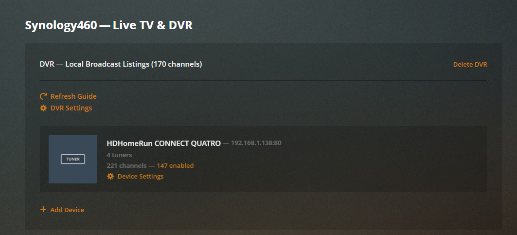

We were away on vacation for the last 10 days or so. This evening I had on a notice that there was a new version of DSM available to download and install. I did that and it does appear that that my guide is working when selecting “HD Channels Only”.
Plex Media Server: 1.22.1.4228
Plex Media Server Filename: PlexMediaServer-1.22.1.4228-724c56e62-x86_64_DSM6.spk
Synology NAS: DS218+ w/ DSM 6.2.4-25556
HDHomeRun CONNECT QUATRO
I can’t say that it makes a lot of sense, but my guide is now working.
I’ll post if the problem comes back.
Picture below for confirmation.

This Suomi lineup appears to be a general country lineup and I see that it is alpha sorted on channel name - which means channel numbers may change
What post code are you ?
Is it OTA or Cable ?
and if cable, who is the cable provider?
I am looking into Finland lineups at the moment
Postal code is: 20540
It’s cable, and provider is Telia.
