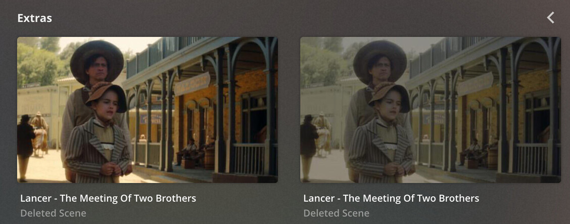

I recently adjusted my existing movie library’s folders to follow the new media scanner standard of including the match source and id in the folder and main feature filename. I have noticed since then that I have 3 situations relating to the extras for my films:
  • Movies with id included from the start
    • Extra’s show up fine, no problems noted
  • Films originally added under just name and year
    • Some to all extra’s are duplicated, selecting either copy plays correctly
    • Extras are not duplicated, play errors “Please check that the file exists and the necessary drive is mounted.” (confirmed to work previously)
No clear pattern noticed between items that duplicate vs error, but have noticed all errors appear to also have Plex included extras. In both cases the films will play. The extras are organized using the sub-folders method per the Plex documentation and had been working previously (and with newer items) as expected.
I can confirm that the files are all visible, at a standardized depth, and in the same movie library folder. Example titles specifically to reference for future discussion, ‘Tenet’ was added under id number scheme and is working fine, ‘Once Upon a Time… in Hollywood’ was migrated and is duplicating some, and ‘Law Abiding Citizen’ was migrated and is erroring on all.

As I noted initially some are duplicating the extras in the Plex interface (both play the same file) while others are just erroring. Looking more into it I think there might be a pattern where anything that’s erroring has Plex originated trailers or special features. For the items with 2 copies of the features listed both play the same file (as there is only 1 file on the disk). If it duplicates it works if one errors they all error. The duplicates have slightly different preview pictures which makes me think it is related to the new scanner.

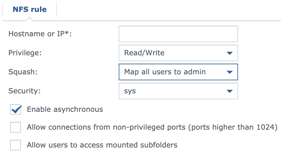

Regarding permissions:
  1. If the mount is done with sec=sys and shared folder permissions allow it
  2. Then you can be guaranteed there aren’t permission problems.
Emphasis here is on what the shared folder still allows.
I prefer to use sec=sys on the Syno NFS and open the shared folder permissions completely. This makes the Syno a ‘big hard drive’ for the workstation.
I then set the linux permissions as i want which disables the Synology ACLs.

Re the permissions portion, on the linux side its mounting at boot with fstab:
<nas ip>:/volume1/PlexLibrary /mnt/Plex nfs defaults 0 0
and the Synology NFS side settings are:
Where the Plex host is statically referenced. There is nothing checked off in advanced permissions on the Synology share. As I recall I did the all to admin mapping due to issues with getting the user auth to work on boot for the Plex so mapping the share to admins and restricting the access to the specific ip’s was the workaround I never got back to cleaning up

I tried moving the beer commercial to a non-indexed area out of the once upon a time folder and this kicked it into clearing up the duplicates on that specific entry, however now that I have put the file back its not re-detecting it.
Okay here we go, I was a bit blind there looking through the logs. The broken ones are still pointing to the non-imdb id’d folders. Finally identified it when I ran across another entry where some of the duplicated items played and some didn’t. So yes this appears to be due to the renaming of the folders. The media is not where Plex is thinking it is, so it cannot play it which does make sense.
It appears the root issue probably relates to the scanning then, because it has found all the movies (or at least I have no trash cans in the library) and every movie I have tested plays, even for those with broken extras.
As noted in my previous post as well, the feature I moved our from once upon a time in hollywood immediately dropped and even though I have put it back to the same spot its not appearing again at this point.
