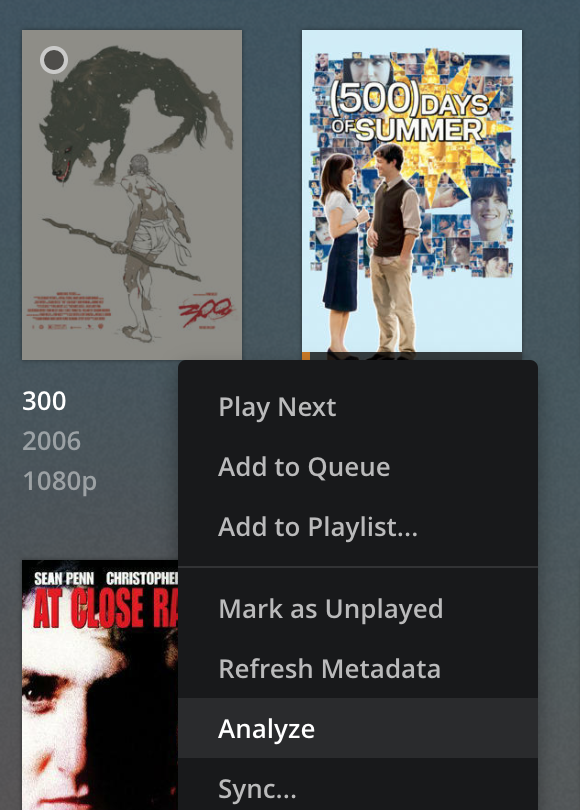

you can do it per library or per item. in this case do per item after the initial scan a
add a new file
scan and give it a minute to complete
if it does not load posters etc
analyze from ellipses menu on bottom right of poster when hovering on poster
refresh metadata

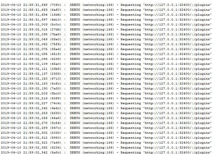

Thank you for the logs
They show an issue between the PlexScriptHost.exe processes and Plex Media Server.exe process where requests are not getting through
As an example - all these requests never showed up at the Plex Media Server.exe process
