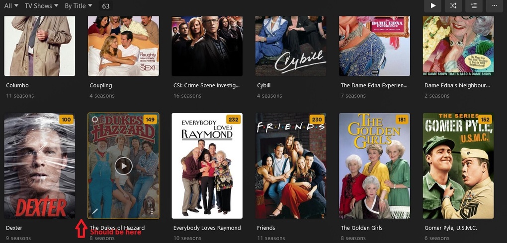

Fabulous - Good suggestion (I was really hoping it was that easy :)), but no. For one thing, it shouldn’t matter as that option not only states “if present,” it indicates artwork and posters. it’s not pulling anything up (not even creating a blank//bad entry). How do i attached screen images (non copywritten? I can upload images of all this
I tested with adding 2 new libraries (using an abbreviated TV show library), 1 with local assets on an 1 with them off. Both pulled Dharma in, although they both thought it was the TV Show “The Season.” I have no idea why it drilled down a level for a name :(. I had to manually force it to the TheTVDB database page.
However, even though both pulled the incorrect show in, it did create an entry (which I could correct). My original library didn’t even do that - it ignored that folder completely. I know I can create a new library, but now I’m determined to figure out what’s causing the hiccup.

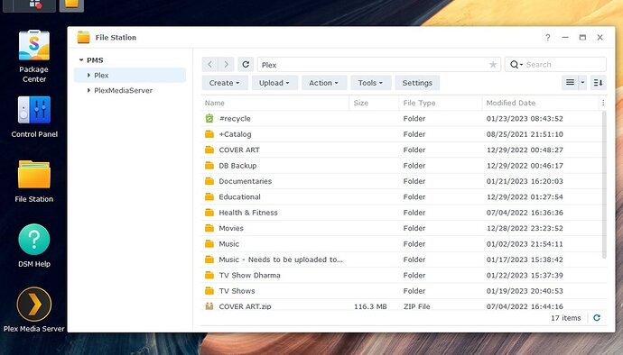

DSM 6 or 7?
With DSM 6, do not put media in the /Plex shared folder.
Is there another folder between TV Shows and Dharma & Greg?
The show folder must be directly below the folder added to the library.
To add to FordGuy,
Like DSM 6 with no media in the Plex shared folder,
On DSM 7, don’t put any media in the PlexMediaServer shared folder.
You CAN put media in the “Plex” shared folder because it’s no longer used for PMS internals / operation.

Here is an image of the file structure - The “root” is the primary folder “Plex”. The Plex server content is in it’s own folder;

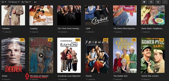

  • It still won’t update my original TV Show library, though (screen shot of it missing, even though folder content is as above pic shows). The newly added TV Show library added it without a problem. I just can’t get the original one to recognize the update on scan.
