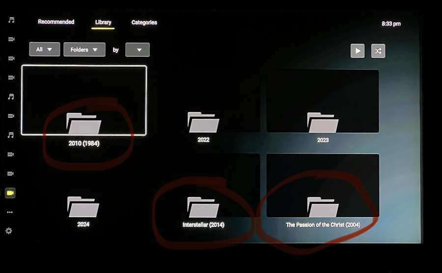

Mystery folders in Personal Videos
Created a new library and added an empty folder, then created a sub folder which I added correctly titled music video video files to, then they were scanned into Plex fine but other mystery folders appear.
I have checked my NAS share and there are no movies in this share/folders by this title. They look like movie titles.
I can replicate this issue by crating a new library with different music video files and same issue occurs.

Screenshot 2024-04-18 190008
Screenshot 2024-04-18 190123
Screenshot 2024-04-18 190206

Have checked the folders and they definitely don’t contain any video files that would match those random movies.

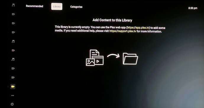

When I click on any of those folders Plex client displays “Empty Folder
There are no items in this folder”
