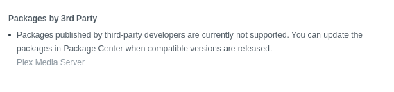

I have a plex life and since NAS synology update to DSM 7 plex no longer works
package not supported
unable to use the service I paid for
what should I do?

Here’s the workaround for your existing plex package to run on DSM 7 (preview)
  1. Open Control panel
  2. Open Task Scheduler
  3. Create a new triggered task
General →
  • Task: Start Plex
  • User: Root
  • Event Boot-Up
Task Settings →
user-defined script:
sudo /var/packages/Plex\ Media\ Server/scripts/start-stop-status start
Select the task and click Run
You can also create a task to stop the plex server.
sudo /var/packages/Plex\ Media\ Server/scripts/start-stop-status stop
Let’s hope for Synology to support 3rd party packages soon.

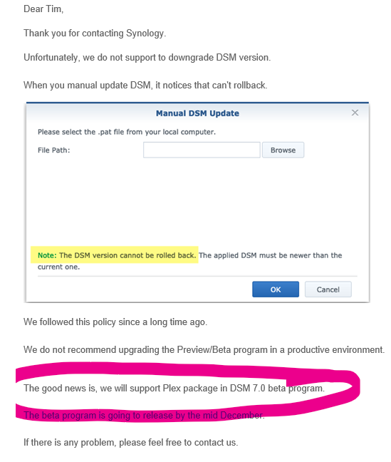

Hi guy’s,
Just got this answer this morning:
That’s two great news in one! First, Plex will be available to beta users - and this will encourage more people to join and test it out - and DSM7 will go beta in a couple weeks - this will address lots of bugs already reported by all of us running the Preview. Looking forward to deploying it!
Not in a couple of weeks
NEXT WEEK
