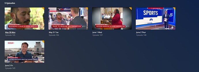

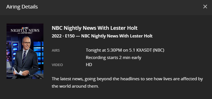

The guide is showing the wrong episode number for the current date vs what that episode is on thetvdb.com below is the 5/31/2022 episode of NBC Nightly news showing episode #150
Below is the listing for the dates that episodes air on thetvdb.com showing that episode #150 would air on June 4th, 2022
This creates an issue when you view the shows as they are future dated
Bumping this to keep it open as it’s still an issue and seems to have gotten worse as the episode recorded on Sunday(6/12) was labeled episode 162 which would be Friday’s(6/17) episode

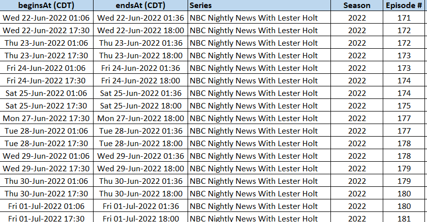

Checked what we have in the EPG. For NBC on channel 5.1 for your area we have:

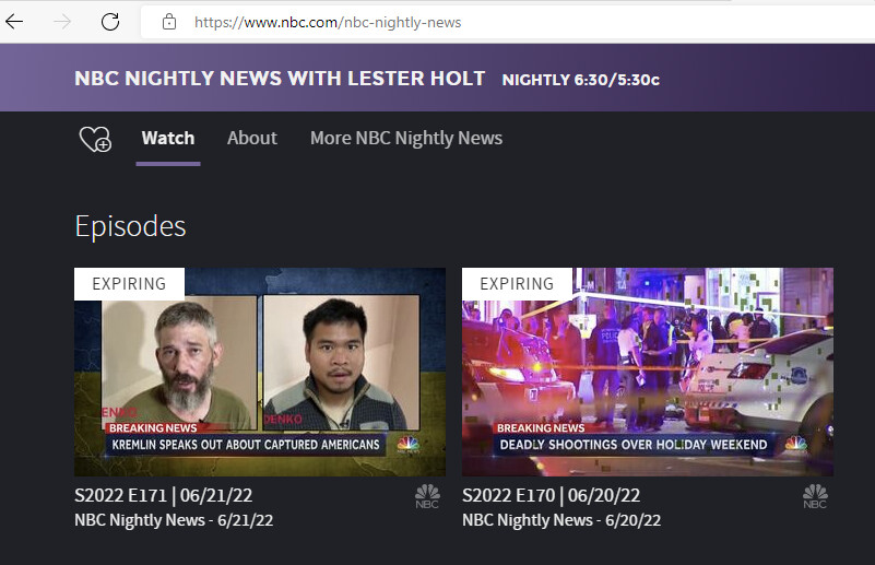

These episode numbers resemble what i can see on NBC Nightly News with Lester Holt - NBC.com

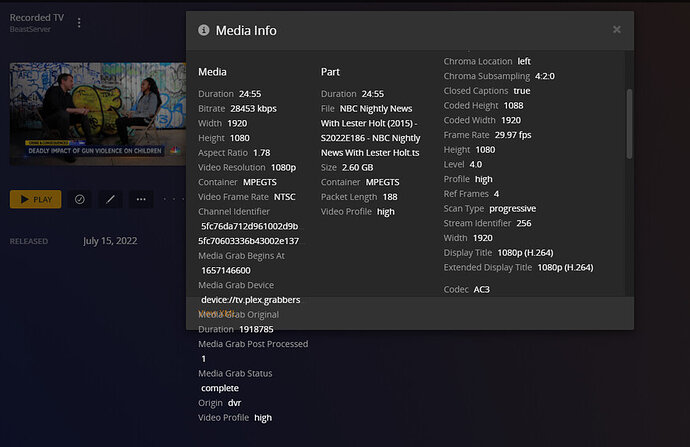

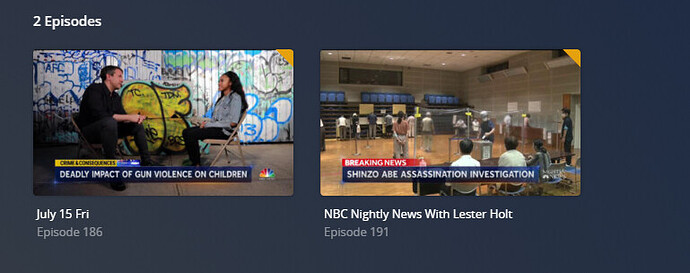

As you can see here it appears Plex is still using thetvdb to get the date based on the episode number. Although from what you showed it appears thetvdb is incorrect and doesn’t match the nightly news true episode number. I have a recorded tv library that I keep but it’s really confusing when you see an episode recorded on 7/6 listed as 7/15 in the application.
Episode 186 was recorded on 7/6 but shows 7/15, the only reason the other one hasn’t gotten a date is thetvdb only goes out to episode 188.

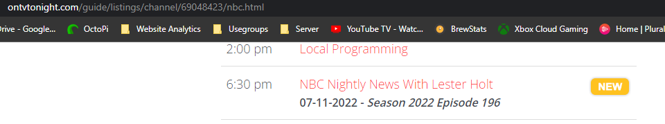

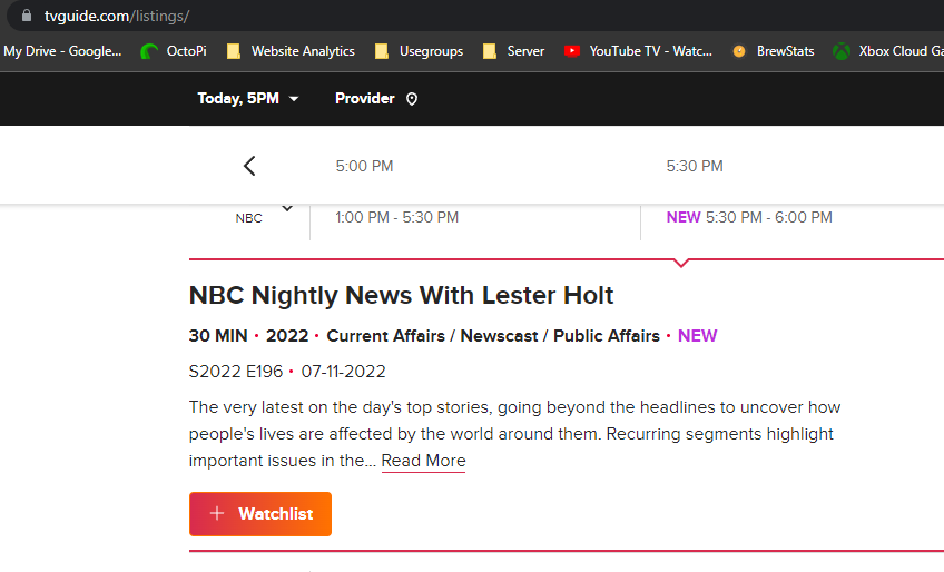

It looks like several locations have several different episode numbers for the same day
TV Guide

OnTVtonight

I already migrated all my recorded TV to another library several years ago.
It shows DVR in the Origin for the NBC News recorded 7/6 that is showing date 7/15
I also noticed this in the Library Advanced settings
Yes the 15th july is coming from thetvdb. Without tvdb and if we were preserving EPG metadata then the date for that recording would have been 6th July
I suspect that the Show itself was previously matched to thetvdb sometime ago in the past. If a show is already matched to the tvdb then new recordings for that show will continue to be tvdb matched overriding the origin=dvr setting for the new recorded episodes
