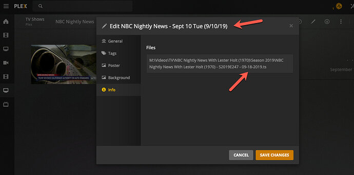

Just wanted to bump this thread as it’s still an issue. From what I can tell the Episode number in the guide data doesn’t line up the theTVDB for the current days episode. If I look at today’s episode in the guide (9/2/2019) it shows E231 but if you look at theTVDB E231 would be for Sunday August 25th it should be reading E239 which is for 9/2/2019. Please contact the provider and figure out why we are getting the wrong episode number returned.

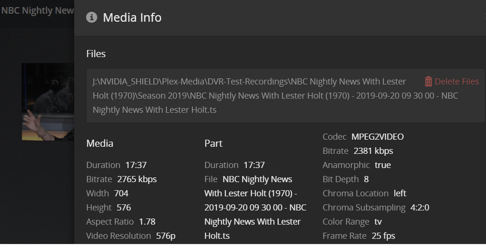

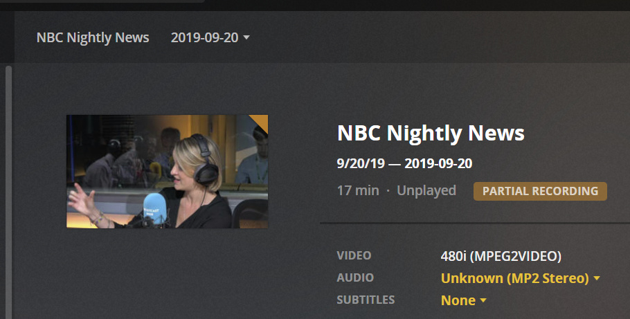

I have advanced my clock and did a dummy recording and this is how it will look like

@sa2000 this is still an issue for me, I did a manual guide refresh today and am still seeing the episode number in the guide not lining up to the episode number in thetvdb. As you can see from the screenshot it’s showing 10/3 for the date but the episode should be 269 not 262.
