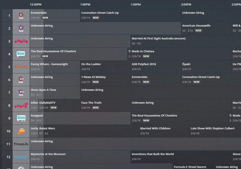

I’m having a similar issue. Some guide data is missing and shows Unknown Airing.
I’m based in New Zealand and it appears to be random. Just blocks here and there without any guide info.

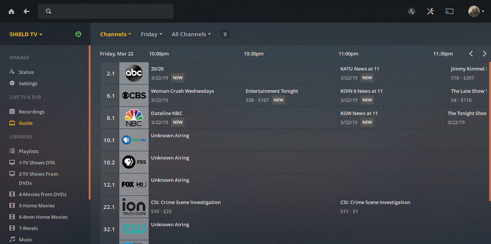

This is still a problem:
Before manual EPG update:
After manual EPG update:
