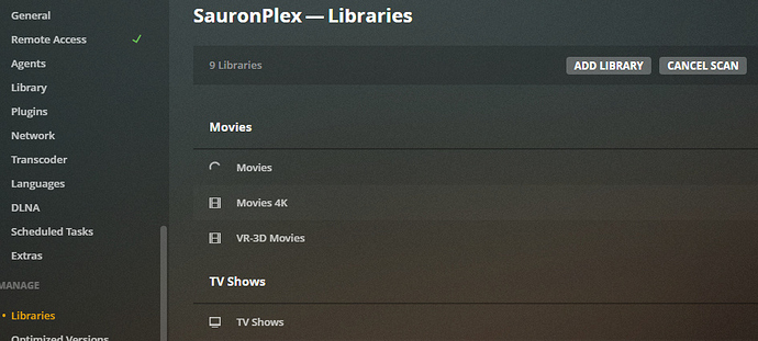

Also, there IS a cancel scan, assuming pms hasn’t crashed/hung up something.
see top right corner
Hi and yes, I canceled scan numerous times but it says it does but then it just keeps spinning away at the top where the “Activity” symbol is and when I click on it, it says it is still scanning which is why I can’t scan my actual new files and why a Stop All Scans button would possibly be helpful if it worked, Cancel was not. BUT…

that cancel scan does stop all scans, unless the scanner is crashed or hung up on something.
that does not mean that a new scan won’t start (you can control automatic scans @ Plex Web > settings > library (uncheck anything that says ‘scan’)
you should also check @ settings > scheduled tasks, and uncheck anything you don’t want to run during maintenance period.
