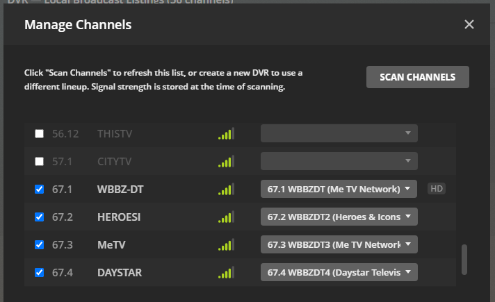

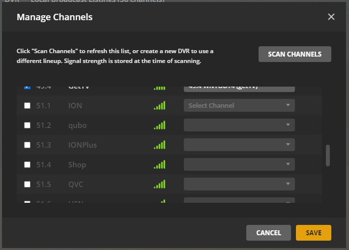

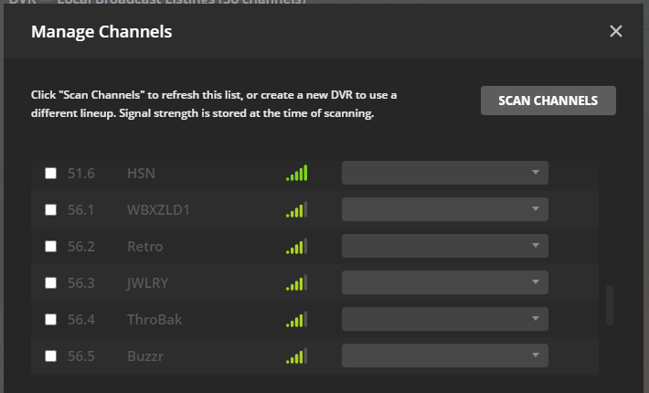

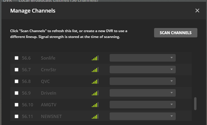

Just deleted and recreated my DVR in Plex since i got a message saying the current EPG would no longer be supported, but the new EPG is missing quite a few channels … like 21 channels
I live in Canada and my postal code L3C 7H5. Here is a list of the missing channels
34.4 - WVTT-CD
34.7 - WVTT-CD
51.1 - ION
51.2 - qubo
51.3 - IONPlus
51.4 - Shop
51.5 - QVC
51.6 - HSN
56.1 - WBXZLD1
56.2 - Retro
56.3 - JWLRY
56.4 - ThroBak
56.5 - Buzzr
56.6 - Sonlife
56.7 - CrnrStr
56.8 - QVC
56.9 - DriveIn
56.10 - AMGTV
56.11 - NEWSNET
56.12 - THISTV
57.1 - CITYTV
Hopefully the folks at Plex, can get this fixed up, because the current guide data is missing about 1/3 of the channels. It would be helpful if there was a built in way to report missing channels as part of the channel association screen that takes place after the channel scan.
