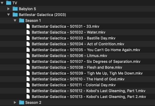

Two quick suggestions:
  1. Don’t download directly into a directory which PMS monitors. It can cause problems for the scanner.
  2. Your file naming could use some work. This support article outlines what the paths and file names should look like:
Here’s an example of how it should look (macOS example, but you should get the gist):

I can only share my experience and what the guidelines suggest. The spaces (between words in the name and around the dashes) are important. As are the folder paths. The matching logic can be forgiving with non-compliant names and paths; right up to the point where it isn’t.
I’m not saying that this is definitely your issue; however, the first part of determining why this isn’t working is making sure best known practices are followed. Then, when it fails, we know that there is something else going wrong and can investigate further.
If you’d like to try a scan and collect some logs, I’d be happy to look at them.

And if you need a utility to help you get your naming/paths sorted out, check out Filebot:
Your file names are wrong - flat wrong - absolutely out of compliance. @pshanew has shown you correct file names.
Plex may work with BAD FILE NAMES, may work for a while, right up until they no longer work. Proper file names - as shown - will always work… unless…
TVDB is broken, like it is now. Anything could happen, or not, and a lot of Not Happening is happening at this time.
While we wait for TVDB to re-appear in this ethereal plane with the rest of us - you can fix your file names.
