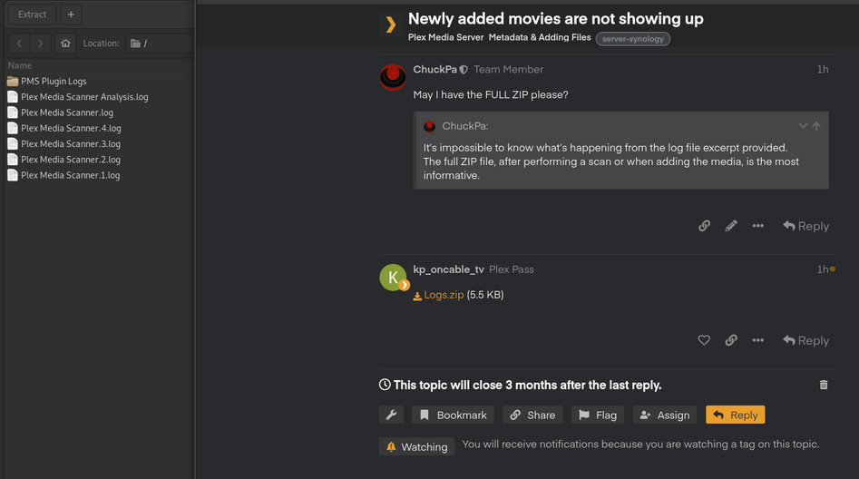

May I have the FULL ZIP please?
Logs.zip (5.5 KB)
What is in the Logs directory?
Do you see the Plex Media Server logs?
All I’m getting here are scanner logs. I need them all please.
I took all log files from the directory.
