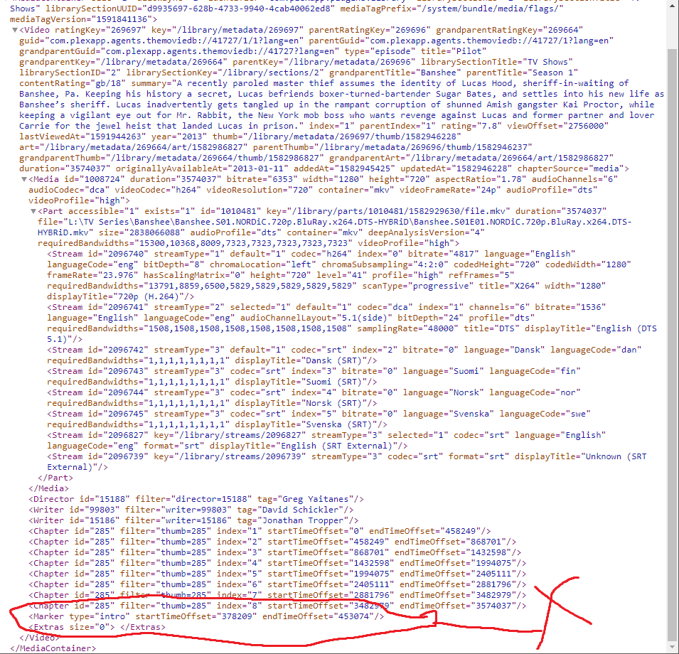

The best way I’m aware of to see Intro Detection progress is with ExportTools:
Yes, when logged into your server on web via app.plex.tv, click on the 3 vertical dots on an episode of a show you you want check, then press Get Info, a popup window will show and at bottom of that is “View XML” Scroll down and look for "<Marker type="intro" startTimeOffset="xxxx" endTimeOffset="xxxxx"/> "

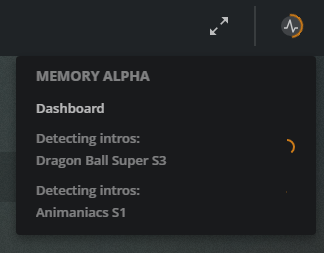

same thing going on here, ver 1.20.5.3600. the transcoder option is unchecked, i tried doing an optimization but nothing was paused. when i restart the server it stops, but then after it detects new intros it goes back to scanning the old show. kind of at the end of my rope here. other than this, the skip function is great… i just don’t need dragon ball super detected THAT MUCH. is there a way to stop it from scanning a particular show at least?
