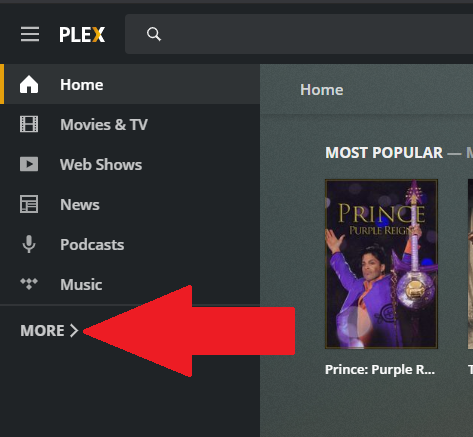

You should see “More” below that (screenshot below). Click on it. You should then see the server and shared libraries. You can then choose which libraries to “pin” to the home page.
To pin a library to your home page, hover over it with your mouse. Click on the three vertical dots on the right. You’ll see an option to pin.

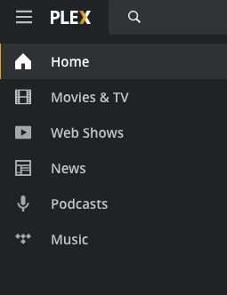

Unfortunately I am not seeing any extra options besides the Plex On-Demand items. Do you possibly need further logs to look at? I still feel like something network related is going on as the remote access page has flipped back and forth constantly.

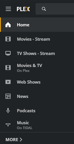

    You should get a Plex Web setup screen, showing you the libraries shared with the test account and the on-demand libraries, with check boxes to pin them to the home page. Select the items you want to pin to your home page and click Finish Setup.
See screen shot below. “Movies-Stream” and “TV Shows-Stream” are the libraries I share with my test account.
When I click Finish Setup, I see the selected items listed on the left side of Plex Web (see below).

Just tried that. Not seeing the “- Stream” options at all. I have, however, excepted the invites and see the server on the mobile app, it just shows offline. It’s like something server-side is giving me the grief.
