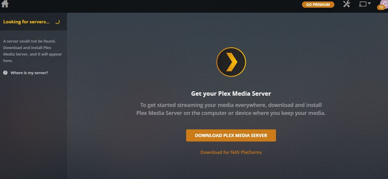

I am using my laptop web browser to access my Synology. I have installed Plex Media Server on the Synology (version 1.8.1.4139) . Plex Media Server is running and when I click the URL on the Synology to open Plex (https://192.168.1.254:32400/web) the URL opens a new tab on my laptop web browser and asks my to login with my Plex account. I login and this is where I get stuck … I’m faced with this screen:
Confused what I need to do??? Plex Media Server is already running on the Synology. Why can’t the browser see it?
Can someone please help? Ideally quickly as it’s driving me mad!

Sorry, I tried that - was it not clear from my original post? My browser does not find the server.

Ok, done all that but still get “looking for servers” in the browser when Plex is opened. ???
