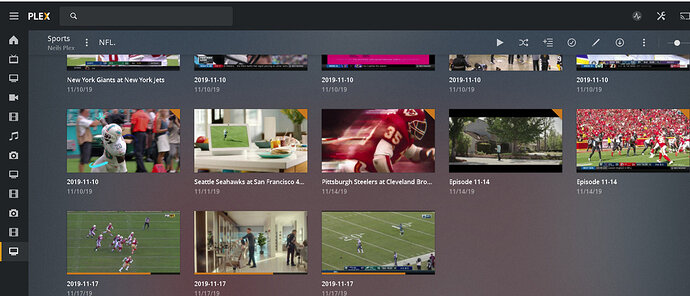

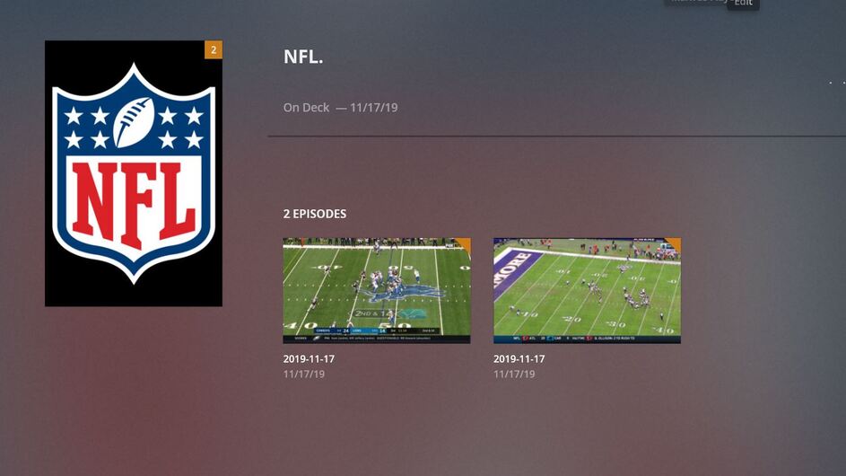

I’m still ending up with games that are recorded under a show titled ā€œNFL.ā€ (It has a period after NFL.) The games are named by date and have no information, despite the Guide having the correct data when watching.
Any suggestions? I feel like I’ve tried every combination of settings and agents I can imagine.

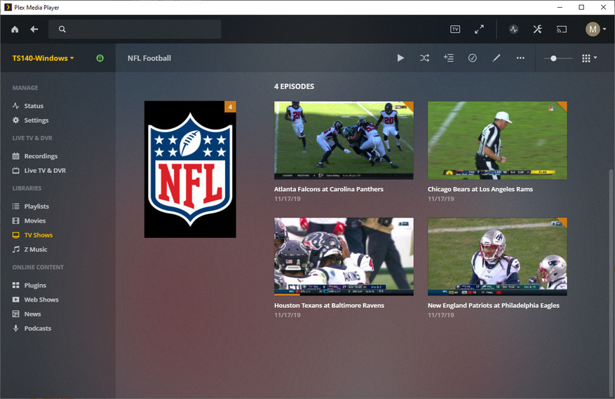

This is how mine looks after recording games on November 17th.
Sundays games all have the date for the title. They originally said Episode-11-17. I also watched the Raven’s game and it marked every game from that day as watched.
Version 1.18.2.2029
Confirmed that the enhanced guide is unchecked.
Something still is not right.
It is still matching to NFL.

It worked perfectly for me. All four games recorded show up in the media player with correct names. I started watching one game (Texans at Ravens) and only that game shows as being partially watched.
