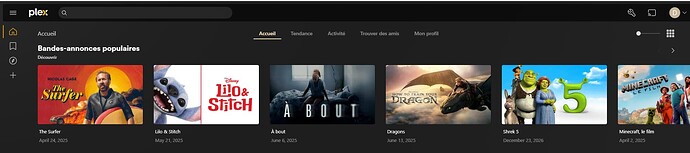

Hello everyone,
Since yesterday evening, my server doesn’t appear anymore on Plex, nor my libraries.
In the Plex settings, I no longer see the dedicated settings for my server.
Strangely enough, last night there was an incident on Plex :

Can you still see your server if you open it straight from the DSM desktop/dashboard or using its local IP from within the same network/subnet (http://[Syno IP address]:32400/web)?

Hi tom80H,
When I do this I have an error 400 bad request : The plain HTTP request was sent to HTTPS port

Have you tried https instead of http?
Make sure to use the actual local IP from within the same network/subnet. No hostname (local or public), or dyndns.
I have tried for https, it worked, my server is displayed but I have a message ‘not authorized’
