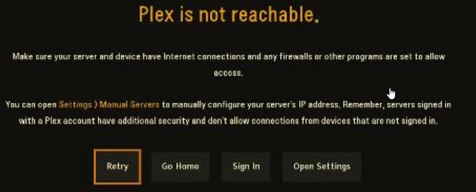

None of my Devices will connect to my Media sever after sever update
Did the recent Plex Medie sever update and now none of my devices will connect to the media sever. Checked all my settings made sure there were no issuse in Windows 10 or the firewall. Thinking about to a reinstall but trying to find a solution before I go that far.

Hi, the same thing happens to me since yesterday, but that trick of yours does not work for me, I had already tried it other times, but it does not work.
Yesterday afternoon I got the typical known error of “Budapest”, and today when trying to start I get this as ati.
I have tried putting the external IP as Internal and neither works.
When I enter the manual configuration of the server, and I close that dialog, I go back to the initial screen, and press Retry or Home and everything is reset as it was at the beginning, it seems like it does not save the information or something.

Same here. Ran the server update before heading to bed last night and today my tv (LG) won’t connect to the PMS. I get the “Plex is not reachable” message and so far nothing has worked to let me reconnect the tv to the server. Worked fine yesterday. It does seem like the app on the tv is signed out for some reason. Doesn’t let me sign back in either. the sign-in button does nothing, same with manual IP and insecure connections, etc. keeps resetting after I fill it in and hit the retry button. At this point, I’m hoping it’s a glitch in the update and it will be fixed soon.

I may have found why plex doesn’t work anymore on both of LG TV.
I think that some certificates on TV has become outdated and that’s the reason, or Plex server as updated their certificates to a new version.
Several HTTPS sites don’t work anymore on TV browser. Some still do.
https://plex.tv is one of them. This one shows clearly that is a cerificate error.

Go into the Network tab on the server in settings, and change it to always on the server. Well either always or preferred.
The above solution works for me, but it isn’t really good enough. I can get my own server, but no one elses.
What plex forgets is that we don’t all upgrade our tvs for the sake of it. Sometimes they have to last a few years.
Did the lastest update for Plex sever and the update on my smart TVs and low and behold evrything seems to be back up and running without remote access for now. Anyone else see better results since updating?
