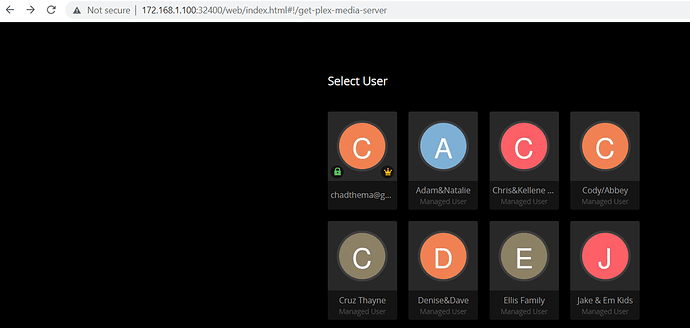

When I delete all associated devices through plex.tv login and try login through the NAS local connection I enter my Plex login info and it allows me to select the user (See below) but when I enter my pin there is no option for me to claim the server. The NAS is on the same network/subnet and even the same static ip address as before.

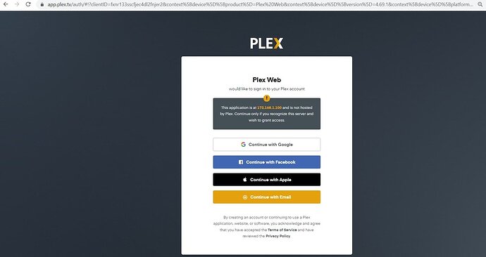

I tried running the claim token command and now I am getting “Unauthorized” response. See below. Any other ideas? I am sorry this is being such a pain.
i don’t think 172.168.1.100 is a compliant RFC 1918 private address which could be issue. Looks like it is owned by Yahoo 172.168.1.100 IP Address Location | SG IP network tools

The 172.168.1.100 is my local lan address for my NAS. Should I be using my WAN IP Address when requesting a new token?
The IP Net 172.168.1 is not in private address space, and as such not recommended, since not only will PMS see that IP Net as one you can’t claim your QNAP from, but it might also collide with the actual owner of that IP Net, if you try to browse to that.
For the B-Class, it’s 172.16.0.0 – 172.31.255.255
Ref: Private network - Wikipedia
To claim your QNAP, try this:
You need to download it, put on your QNAP, and follow this:
Or read this, specially On a Different Network
