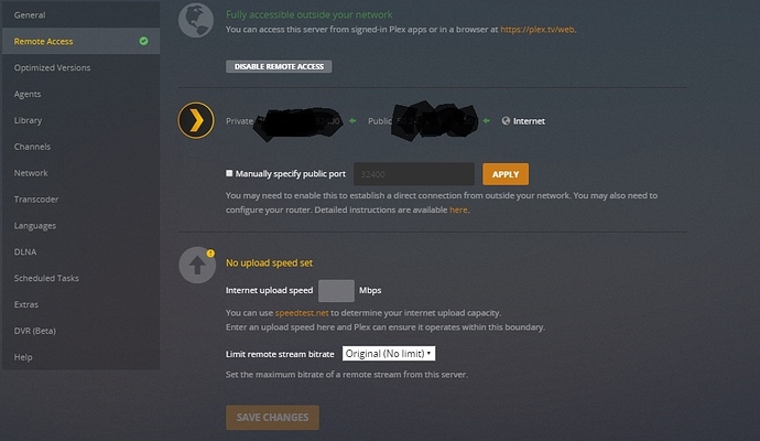

Hopefully this is the right place to post this. I keep getting this message, but I’m able to access my media away from home (such as work). I can access the media, watch it, I have no problems there, but it just keeps telling me
but then this shows up as well
is there something I’m doing wrong or need to fix? Like I said I haven’t noticed a problem, but I just don’t know if its something waiting to go off and stop working
because with a refresh i get
is this just something that happens and can go back and forth? I’m still pretty new with all of this

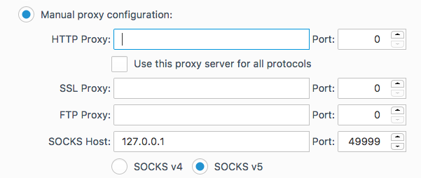

I was only able to get this to work by setting this up from the plex box “locally”.
Let’s say the box that is running plex is at local ip 10.1.1.6 on port 32400
If I go to 10.1.1.6:32400 from the browser on another local machine (let’s say its ip is 10.1.1.20) on my network and try to set up outside access, it will not work.
Since the box running plex is headless, I set up a local socks proxy in firefox using 127.0.0.1 and a random port (49999 in this case), then sshed into the box with tunneling over that port.
ssh username@10.1.1.6 -p 22 -D 49999
Then in firefox (with the socks proxy running) I connected to 127.0.0.1:32400 and set up the outside network connection.
