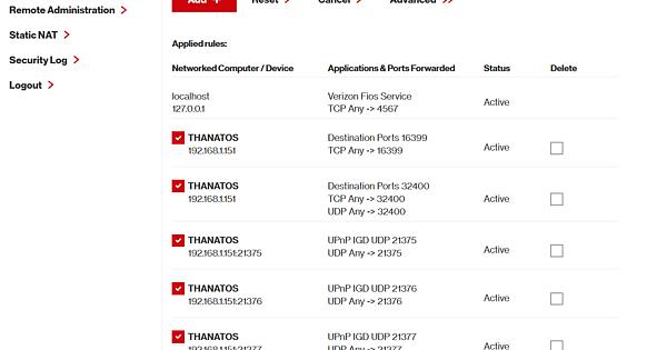

My computer is staticed on my router using a dhcp reservation and I am forwarding 32400 -> 32400 that I have manually set. I’ve verified that the port was indeed forwarding and have restarted everything between the server and the internet, as well as fully reinstalling the server program after deleting all the relevant registry keys and moving the appdata database to another location. Some of the errors I’ve been getting are:

Can you provide a screenshot of the port forwarding page from your router and the remote access page for PMS?
Yes, I verified it was the same, the managed switch was set up with only some basic qos. I’ll get you the screenshots in a sec.
I don’t think your port forward is correct. Can you show me the page to set up a new one and fill it in the way you did, but don’t apply it?
Added some notes in the details

I still can’t ping your server so something is still not setup correctly.
