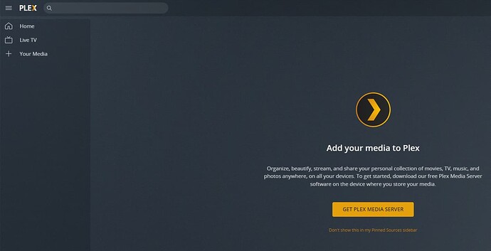

hi.
I logged out of the account linked to PLEX, which was previously authenticated and operated normally in order to try various things.
And the linked server was also removed.
But when I log in to my account again, the media server is not displayed.
Does anyone know how to solve it?

Same problem here. Plex Media Server is installed, yet doesn’t see it and keeps saying to install it again.
I’ve tried several times but it still doesn’t work.
I’ll attach the log, please check it.
