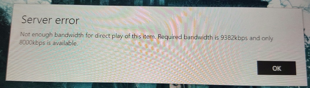

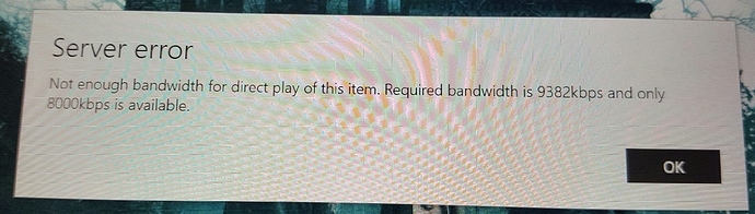

Well played around and I’ve determined something is wrong with these functions. I have my limit set to 8Mbps, and instructed my buddy to change the setting on his end to be 8Mbps as well, but he still gets the following error:
If there is not enough bandwidth to playback a particular movie via direct play, then why isn’t it falling back to transcoding?
For now I’ve removed the stream limits, as something clearly doesn’t work right.
Plex has two sets of bandwidths of which the more accurate is newer. Many clients only read the older set when determining whether to direct play or transcode. Either way, the recommended procedure for client initiating playback does cover this situation. Check to ensure your client is up to date as it may have already been changed to follow the new procedure. Also it would help to know what the client was in this case.
