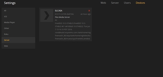

Can’t find a way to remove old server Nucshuco. Not showing under devices. I removed SLCASA and then logged back in, but still showing up.

its not in the device list. that is the problem im having. if you look at the pics there is only one server in there.
