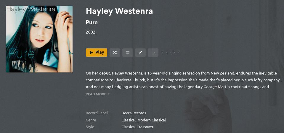

Had a little time this afternoon to run a test with build plexmediaserver_1.31.2.6700-baa28a637_amd64.deb. This is what I done …
With build plexmediaserver_1.31.0.6654-02189b09f_amd64.deb I updated 1 album from ID3v2.3 to ID3v2.4 tags and including two genres …
Screenshot from 2023-02-14 13-51-54
… and force refreshed the album. As expected plex sees only 1 of the genres.
Then updated to build plexmediaserver_1.31.2.6700-baa28a637_amd64.deb and afterwards force refreshed the album. Plex now sees both genres as seen in the screenshot below.
So looks good to me. I’ve only tested mp3.

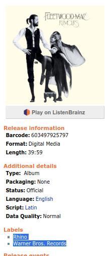

Fair enough. Reason I mentioned it is that many releases get tagged with musicbrainz picard as having multiple labels, here is one example https://musicbrainz.org/release/74d91370-12d3-4ea6-b3d2-fdc983f0196c with two labels.
Screenshot from 2023-02-14 16-24-22
Rhino is now a subsidiary of Warner. But the label is still only “Rhino”, while Warner is the holding Label - MusicBrainz
