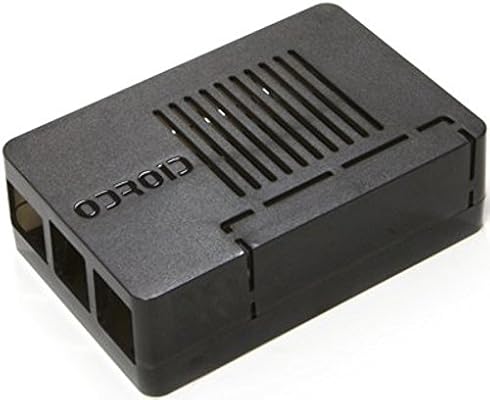

@Seanhonour I personally used this one
Amazon.com
Thanks for the suggestion, i had seen this case but not very keen on it.
