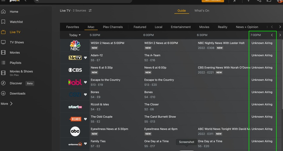

Any updates to this? I have the exact same issue. Guide only populates daily through 7pm, then “Unkown Airing”, until the guide refreshes overnight. PMS running on iMac, have deleted the DVR, added back, rebooted, re-scanned channels. I was considering a PlexPass so I could DVR shows, but am holding until the guide is fully populated. I searched through the forums here and found others with a similar issue but can’t find a resolution. My apologies if I missed it.
iMac 2017, running the latest version of Monterey, connected to HDHomeRun FLEX 4K. Guide is fine on HDHomerun app, but I’d like to use Plex since the guide is superior, it operates on more hardware and is where most of my media is managed.

Unfortunately, no dice. That didn’t seem to have an effect. The guide continued to display unknown until this morning and symptoms are the same where nothing beyond 7pm displays anything other than “Unknown Airing”.
Log attached
Plex Media Server.log (5.5 MB)
