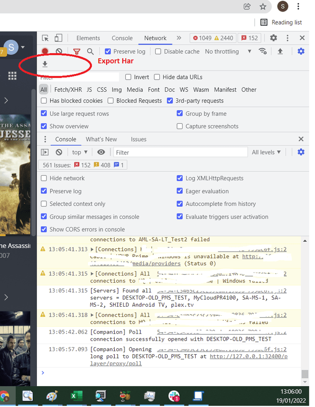

If the problem persists - when using latest Plex Web version (https://app.plex.tv/desktop) , would need debug server logs and I think also since it is reproducible for you, to get browser dev console verbose network logging (through F12) and downloading the har file
The har file would have tokens so needs to be sent zipped by Private Message
Please indicate when the session was ended
Example screenshot of browser dev console network logging
