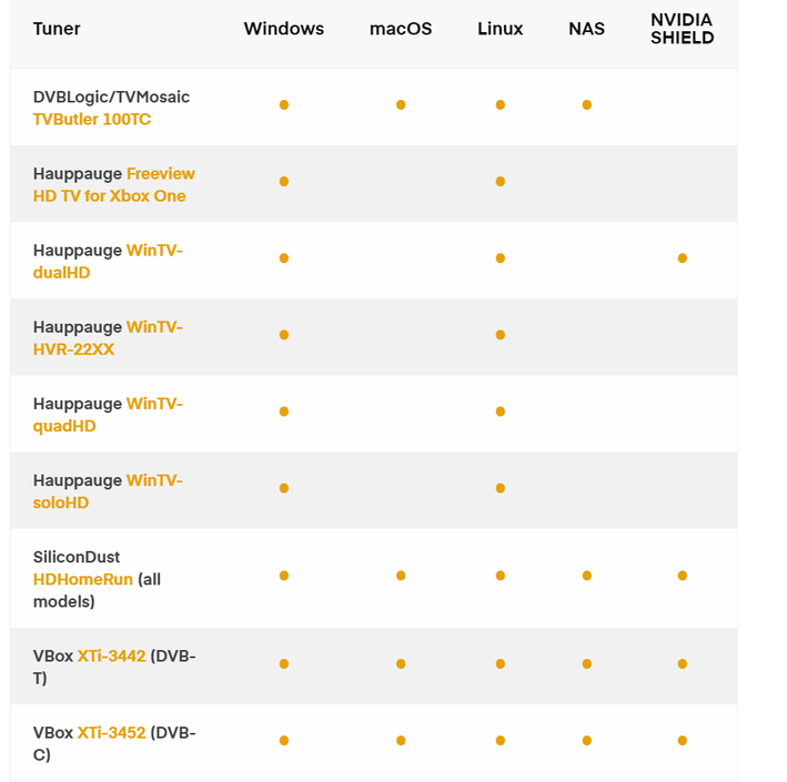

Is the VBox Gateway also an unsupported tuner?
Correct. The officially supported tuners are listed in https://support.plex.tv/articles/225877427-supported-dvr-tuners-and-antennas/. There are some devices that may just work, but then again, they may not. Plex does not test on these other devices.
Yes, but on this website
is shown, that VBox Gateway is a supported Tuner!!
And i use this supported Tuner VBox XTi-3452 (DVB-C)
What now?
Thanks for understanding!
Best regards
Below you can see my supported tuner:
VBox XTi-3452 DVB-C
So why is my tuner not supported, how you say?
Oh sorry. When you said Gateway I thought that was a different model. Yes, the XTi-3452 is supported. That device is for a cable conenction. Have you checked if the channels you are trying to view are encrypted. Plex does not support encrypted channels. If you can provide me the logs I requested before so I can check the error, this may be the reason it is not working for you.
