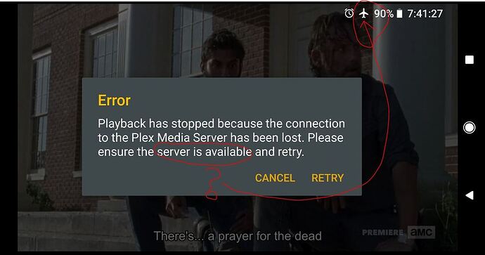

Pixel 2 XL here, same issue, using local files (synced from my Plex server) and I’m on Airplane mode - which means the error message isn’t describing the issue correctly…
