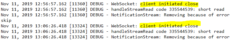

Plex is often getting stuck while watching a video externally via transcoding. The specific video I’ve been having trouble with is a 9.7Mbps 1080p file which I am converting to 4Mbps 720p. Every 10 minutes or so, playback will stop and I have to close the player and start the stream again to get it going. The dashboard shows CPU usage drop to 0, then bandwidth drop to 0 shortly afterwards and then playback will stop once it reaches the point it had buffered to.
I’ve attached the Plex Media Server.log with debug logging on and also a picture of the Dashboard to show when the playback stopped.

This is what I see in your logs -
Every 10 minutes or so the client (your web browser) initiates a close.

I think that might be when I close the player to start playback again, and at that point something has already gone wrong?
