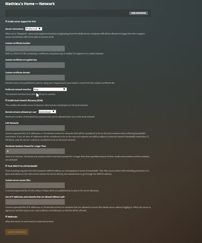

Screenshot your entire Settings > Network > Show Advanced
It might take two screenshots. You can shrink it a bit, but keep it readable.

Attached is the configuration of the network.
Thanks,2019-09-16%2012_50_59-Plex%20-%20Brave
Nothing looks odd with your network. Secure login isn’t required,
and you’ve stated that remote access works well.
